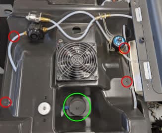

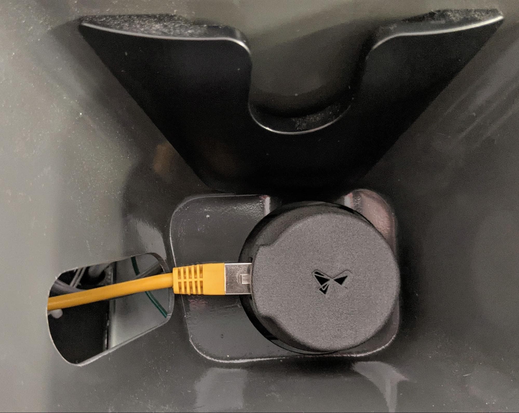

Open the access door to the IR sensor panel, located on top of the printer next to the hopper. Lift the IR sensor and disconnect the cable from it. Set the IR sensor aside on a flat surface with the sensor window facing up. Feed the IR sensor’s cable down through the plastic shroud.

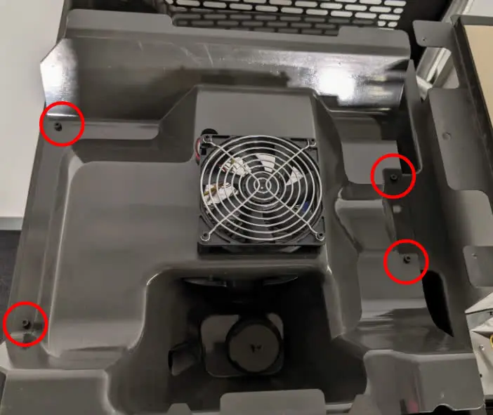

Step 2: Remove the upper cooling shroud mounting screws
Using a 3 mm hex driver, loosen and remove the four 8 mm M4 socket head screws securing the upper cooling shroud to the printer. Newer printers also include four washers. Set the screws and washers (if present) aside. Do not separate the upper cooling shroud from the printer at this time.

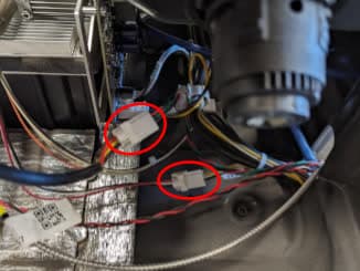

Disconnect the nitrogen solenoid valve from the cable labeled F1+ Nitro N2 Valve Cable. Disconnect the nitrogen pressure sensor from the cable labeled F1+ Nitro Pressure Sensor Cable. Disconnect the cooling fan from cable C047.
For each, disconnect the cable by opening the tab and pulling the plastic connectors apart. Do not pull on the wires themselves.

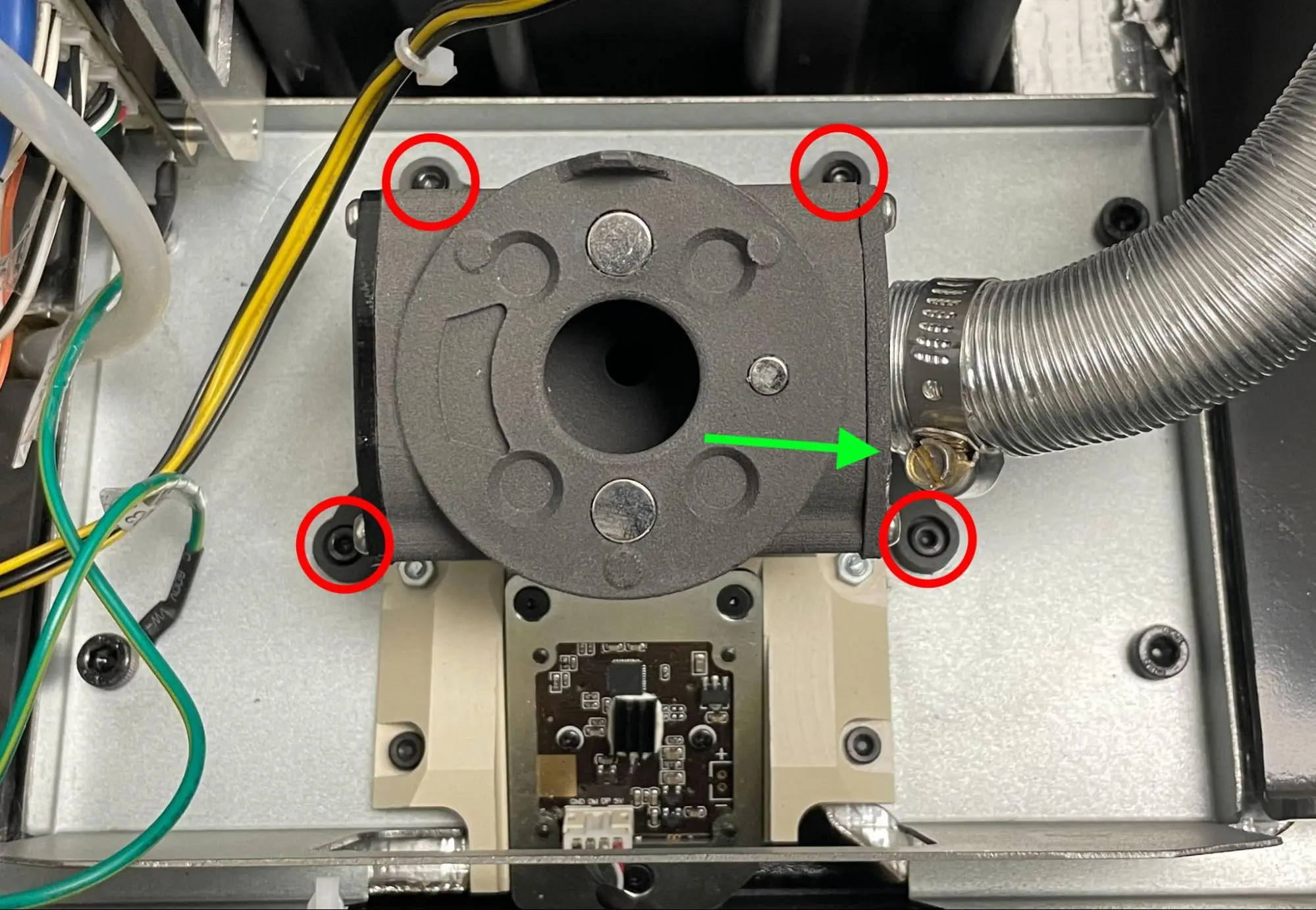

Step 1: Disconnect the duct from the flow body
Using a 6.5 mm slotted screwdriver, loosen but do not remove the ring clamp screw on the side of the flow body. Pull the aluminum duct away from the IR sensor flow body.
Step 2: Remove the IR sensor flow body mounting screws
Using a 2.5 mm hex driver, loosen and remove the four 5 mm M3 socket head screws securing the IR sensor flow body to the printer.

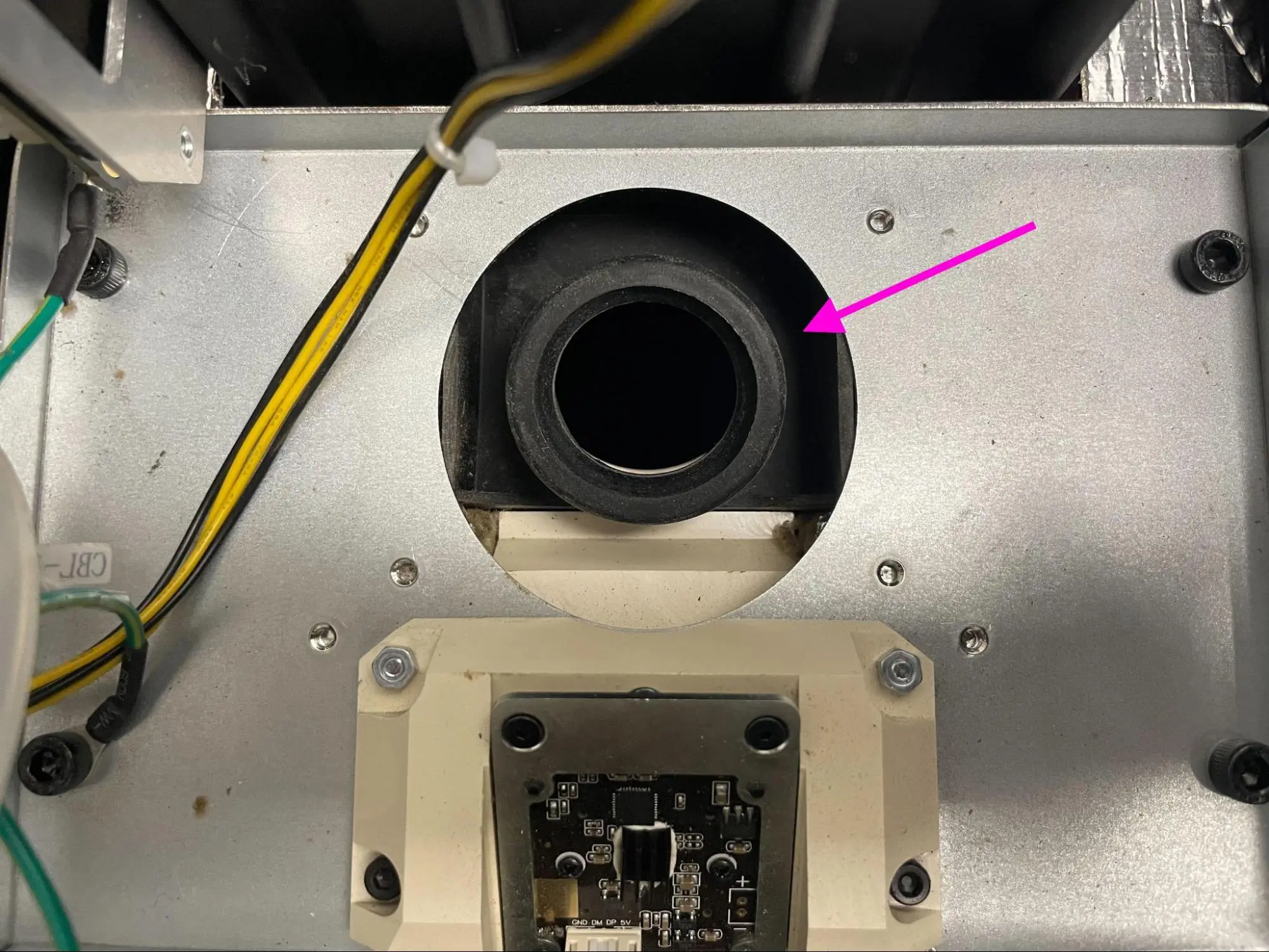

Look up at the ceiling of the print enclosure. Locate the rubber gasket extending down from the IR sensor flow body. Reach inside the print enclosure with one hand and hold the gasket in place. With your other hand, lift the IR sensor flow body off of the printer. Do not remove the rubber gasket. If it comes loose, reposition it as shown here.

Orient the new IR sensor flow body with the IR sensor mount facing up and the hole for the aluminum duct facing right. Position the replacement IR sensor flow body onto the printer but do not secure it.
Step 2: Inspect the IR sensor flow body positioning
Install the replacement IR sensor flow body

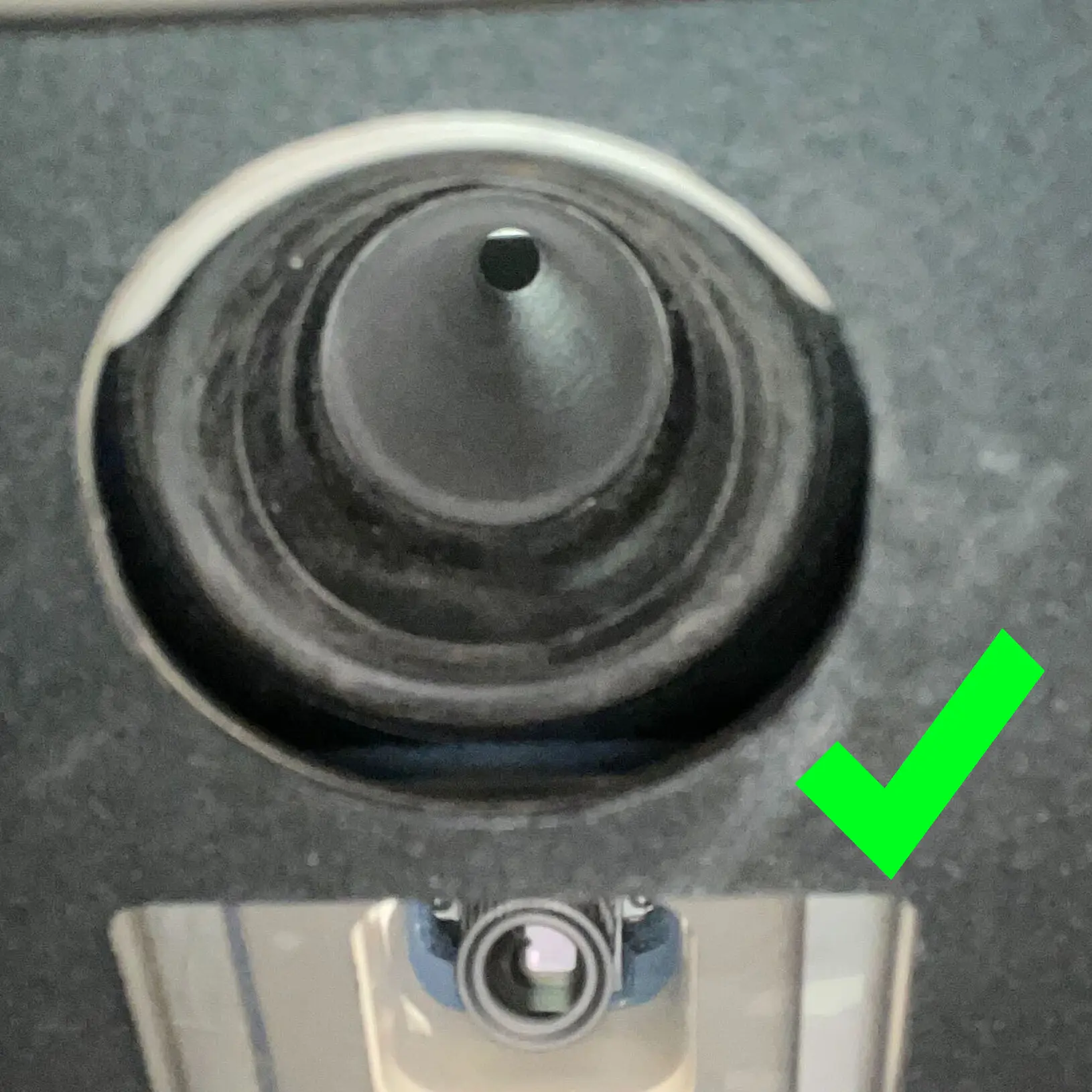

Use a telescoping mirror to inspect the aforementioned rubber gasket from inside the print enclosure. Confirm that the edge of the gasket is even and flush against the printer ceiling, as shown.
Tip:
If the gasket flange is not seated properly, use a gloved finger to guide it into place from inside the print enclosure. If it is difficult to reseat, remove the IR sensor flow body, readjust, and try again.
Step 3: Secure the IR sensor flow body
Once the rubber gasket is properly seated, thread one 5 mm M3 socket head screw into each of the four screw holes in the base of the IR sensor flow body. Using a 2.5 mm hex driver, tighten until snug.
Step 4: Recheck the gasket
Use a telescoping mirror to check that the rubber gasket did not shift after securing the replacement IR sensor flow body. If it did, readjust its position.

Reconnect the cooling fan connector to the socket labeled C047. Reconnect the solenoid valve to the cable labeled F1+ Nitro N2 Valve Cable. Reconnect the N2 pressure sensor to the cable labeled F1+ Nitro Pressure Sensor Cable.

Position the top cooling shroud by holding it from the front edge so that the cables covered by the shroud can still be accessed. Feed the IR sensor’s Ethernet cable back through the cutout in the top shroud.
Step 3: Mount the upper cooling shroud
Lower the upper cooling shroud on the printer, aligning the four screw holes in the shroud with the corresponding screw holes in the printer frame. Ensure the shroud is positioned so that there is a uniform gap around the IR sensor flow body. If there is overlap, the IR sensor will not fit correctly.
Replace the top cooling shroud
Step 4: Secure the upper cooling shroud
Thread one 8 mm M4 socket head screw into each of the screw holes in the upper cooling shroud. Using a 3 mm hex driver, tighten until snug.

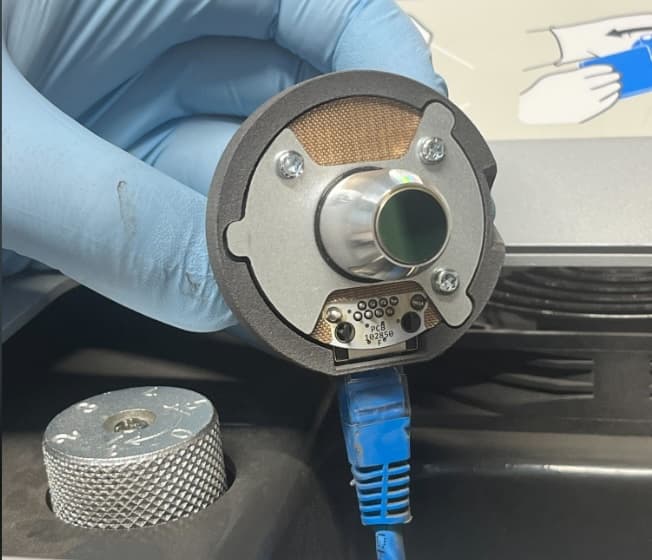

Inspect the IR sensor lens for debris and clean it if necessary. Attach the ethernet cable to the IR sensor, then place the sensor back into its mount.
