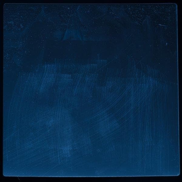

Scratches
Slight scratches in the film-coated layer normally appear after use and should not affect print quality.
alt text
If scratches are heavy or affect print quality, use PreForm to move prints away from the scratched area or replace the tank.

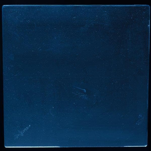

Indentations

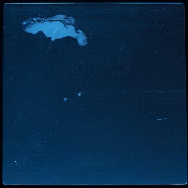

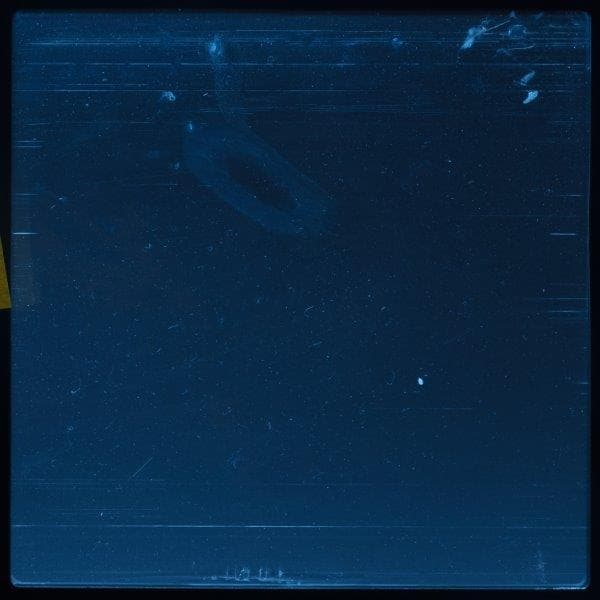

Gouges and punctures
A gouged or punctured tank requires replacement. Gouges and punctures in the film bend light and prevent the laser from curing resin properly. They may also allow resin to leak into and cure under the film, which can lead to further damage.
alt text
alt text
Common causes for gouges and punctures include:
  • using a sharp tool inside the tank
  • using excessive force to scrape the tank
  • print failures

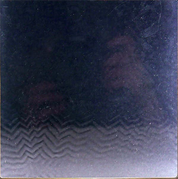

Rippled surface
Rigid Resin and Grey Pro Resin are high performance materials that can accelerate wear on the resin tank. Ripples usually appear in Resin Tanks LT after use with 1–2 L of these two resins.
While the rate of wear depends on a variety of print factors, ripples typically begin to form at the edges of the tank and spread toward the center. Ripples in the film-coated elastic layer may cause parts to print with a wavy or rippled surface on smooth or flat areas.
alt text
Rippled surface on the film-coated elastic layer on Resin Tank LT.
If ripples on the tank bottom affect print quality, either use the Layout tool in PreForm to print around the affected print area or replace the tank.
