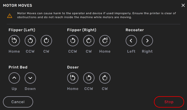

Motor Moves touchscreen
To use the Motor Moves menu:
  1. On the touchscreen, tap the wrench icon. The Maintenance menu appears.
  2. Tap Motor Moves. The Motor Moves screen appears.
  3. Read and acknowledge the warning message.
  4. To move any of the components, touch and hold any of the controls.
    • Stop: Use this control to stop all motors and release their holding torque.
    • Home: Sends the component to its home position. For the buffer and hopper flippers, this is 9 o'clock and 3 o'clock, respectively. The Z-drive and recoater do not have defined home positions.
    • CCW: Rotates the flipper or doser counter-clockwise.
    • CW: Rotates the flipper or doser clockwise.
    • Left: Moves the recoater towards the buffer.
    • Right: Moves the recoater towards the hopper.
    • Up: Moves the Z-drive (and thus the print bed if a build chamber is inserted) upwards or turns the bevel gear clockwise.
    • Down: Moves the Z-drive (and thus the print bed if a build chamber is inserted) down or turns the bevel gear counter-clockwise.
  5. To stop moving any components, release the control or tap Stop.
