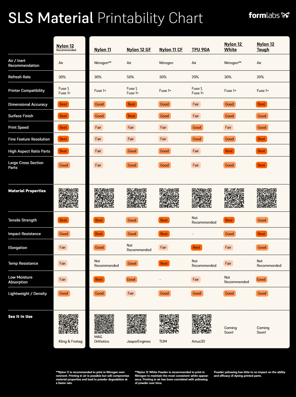

| Nylon 12 Recommended |
Nylon 12 Tough | Nylon 11 Pro | Nylon 11 | Nylon 12 GF | TPU 90A | Nylon 11 CF | Nylon 12 White | |
| Printer Compatibility | Fuse 1 Fuse 1+ 30W Fuse X1 |
Fuse 1+ 30W | Fuse 1+ Fuse X1 (Q1 2027) |
Fuse 1+ 30W | Fuse 1 Fuse 1+ 30W Fuse X1 (Q2 2027) |
Fuse 1+ 30W | Fuse 1+ 30W |
| Printing Environment | Air (Fuse 1+ 30W) Nitrogen (Fuse X1) |
Air | Nitrogen (Fuse 1+ 30W)1 Nitrogen (Fuse X1) |
Nitrogen1 | Air | Air (Fuse 1+ 30W) Nitrogen (Fuse X1) |
Nitrogen | Nitrogen2 |
| Minimum Refresh Rate | 30% | 20-40% | 30% | 30% | 50% | 20% | 30% | 30% |
| Printing Properties | ||||||||
| Dimensional Accuracy | Best | Best | Best | Good | Best | Fair | Good | Good |
| Surface Finish Quality | Best | Good | Good | Good | Best | Fair | Good | Good |
| Print Speed | Best | Best | Good | Fair | Fair | Good | Fair | Fair |
| Fine Feature Quality | Best | Best | Best | Fair | Fair | Good | Fair | Good |
| High Aspect Ratio Parts | Best | Best | Fair | Fair | Good | Fair | Good | Best |
| Large Cross Section Parts | Good | Best | Good | Fair | Good | Fair | Good | Good |
| Material Properties | TDS | TDS | TDS | TDS | TDS | TDS | TDS | TDS |
| Stiffness | Best | Good | Best | Best | Good | Not Recommended | Best | Best |
| Impact Resistance | Good | Best | Best | Best | Good | - | Best | Good |
| Elongation | Fair | Good | Good | Good | Not Recommended | Best | Fair | Fair |
| Heat Resistance | Good | Good | Good | Good | Best | Good | Best | Good |
| Low Moisture Absorption | Fair | Best | Good | Good | Best | Fair | - | Not Recommended |
| Lightweight / Density | Good | Good | Good | Good | Fair | Good | Good | Good |
| See It In Use | Kling & Freitag | Coming Soon! | Coming Soon! | MAG Orthotics | Jasper Engines | Artus3D | TUM | Coming Soon! |
1 Nylon 11 and Nylon 11 Pro are recommended to print in nitrogen for all new customers. Printing in air is possible but with often material property compromises and powder degradation at a faster rate.
2 Nylon 12 White is recommended to print in nitrogen to maintain the most consistent white appearance, but can be printed in air with noted yellowing of powder over time. Yellowing of the powder has little impact on dyeing capability of the parts.
この表のフルサイズPDFバージョンは、こちらをクリックしてください。寸法精度、表面品質、その他の評価基準の詳細については、以下のパウダーのパフォーマンスと部品形状に関する考慮事項のセクションをお読みください。
