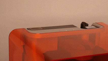

  6. Cover the resin tank with its lid.

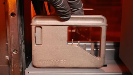

  11. Retrieve four alignment shims and hex key from the tool caddy
    • For Form 4 generation printers: Use the 4 mm hex key.
    • For Form 4L generation printers: Use the 5 mm hex key.

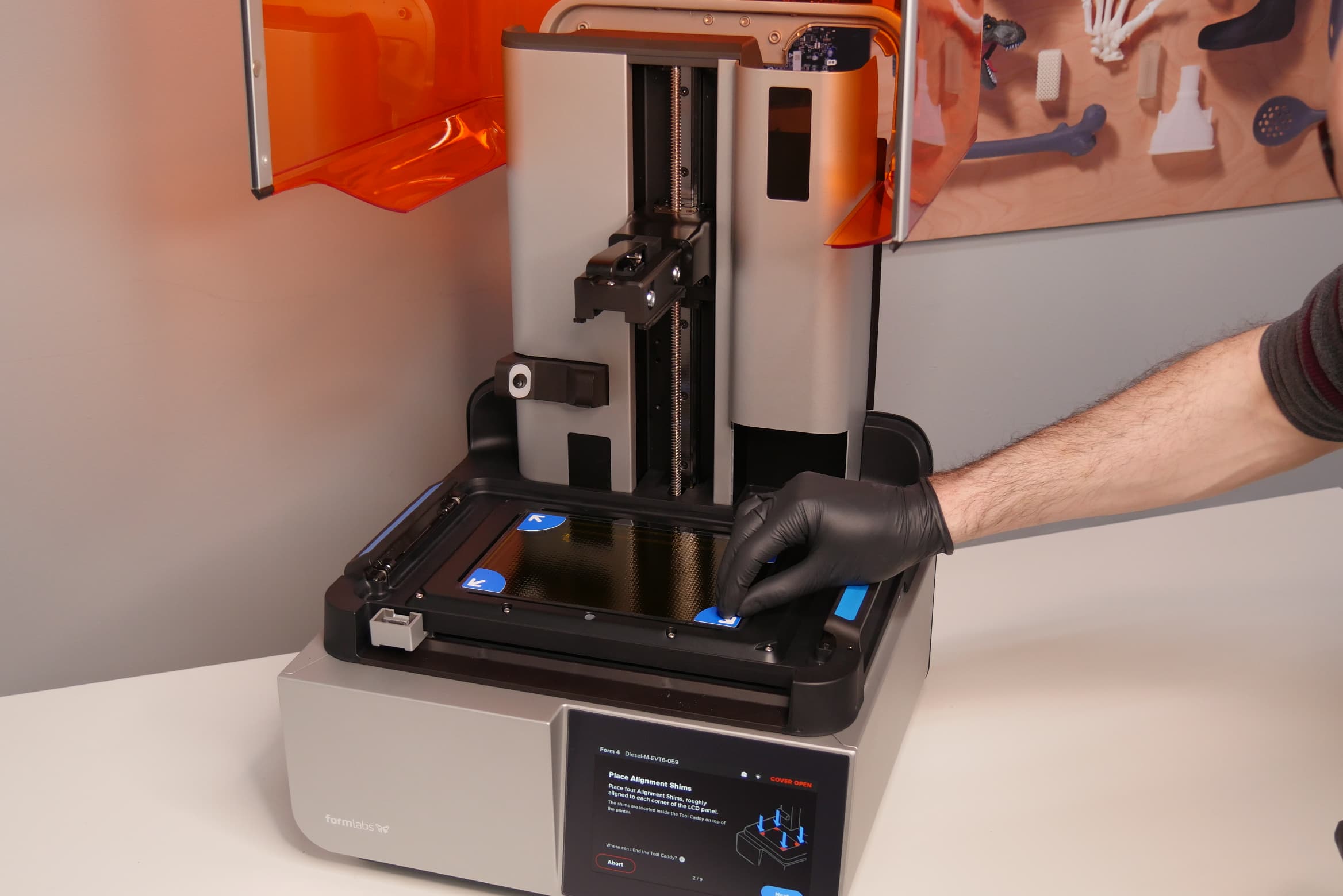

  1. When prompted, place the four alignment shims on the corners of the LPU. Tap Next.

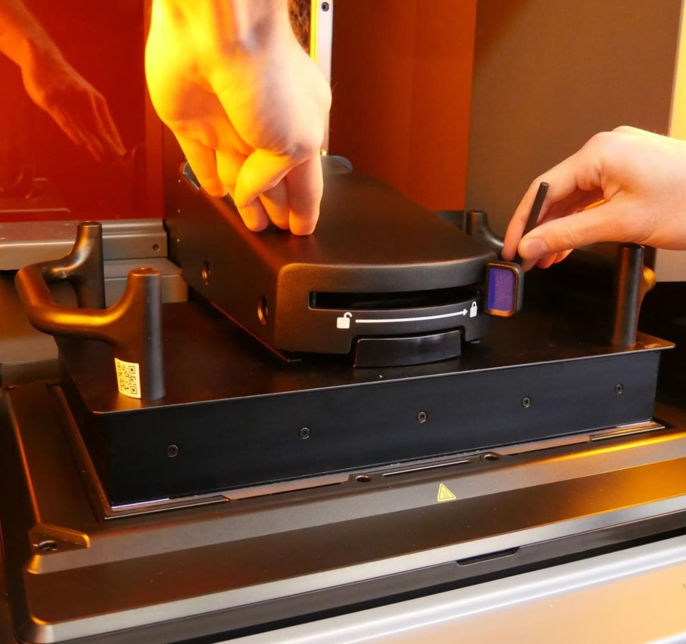

  1. Insert a clean build platform. Make sure it is completely free of resin. The build platform will make contact with the Light Processing Unit during alignment, and any resin residue may cause contamination or damage.
    • If you are using a Form 4 Flex Build Platform or Form 4L Flex Build Platform, make sure that the print surface is properly installed on the build platform body.

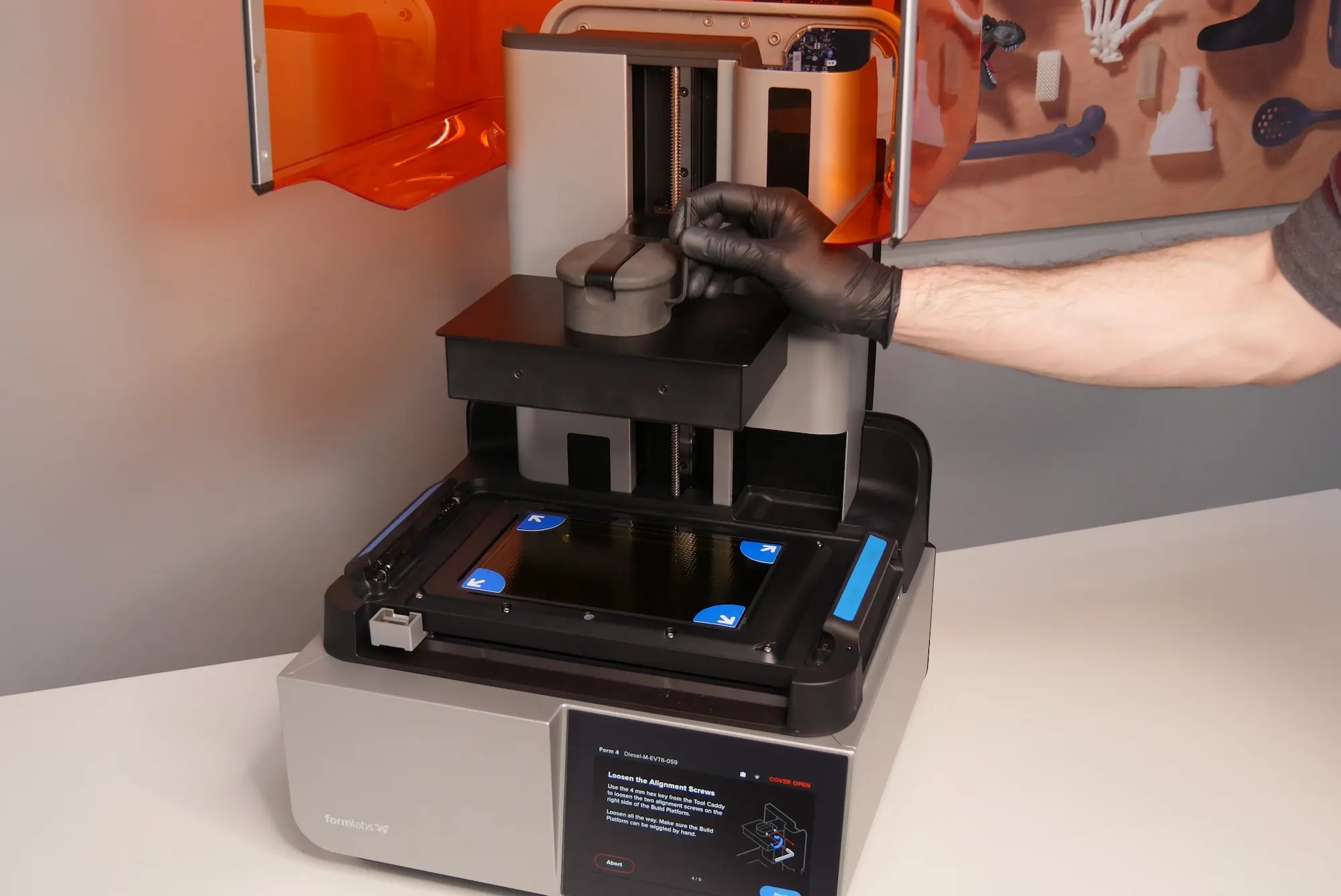

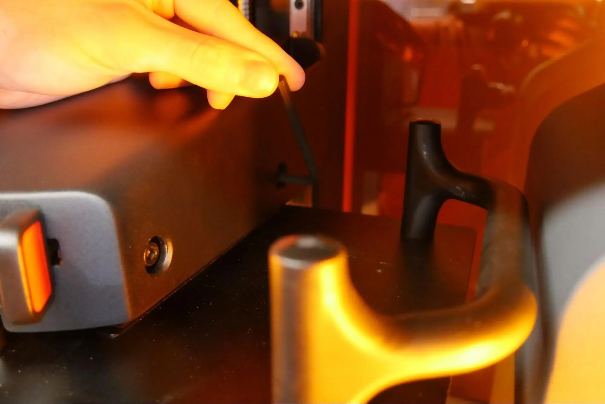

  2. Loosen the alignment screws on the build platform.
    • For Form 4 generation printers: Use the 4 mm hex key to loosen the two alignment screws on the right side of the build platform. Loosen the screws for 1–2 turns until you can wiggle the build platform by hand. Do not remove the screws.
    • For Form 4L generation printers: Use the 5 mm hex key to loosen the four alignment screws on the build platform. There are two screws on each side of the build platform.

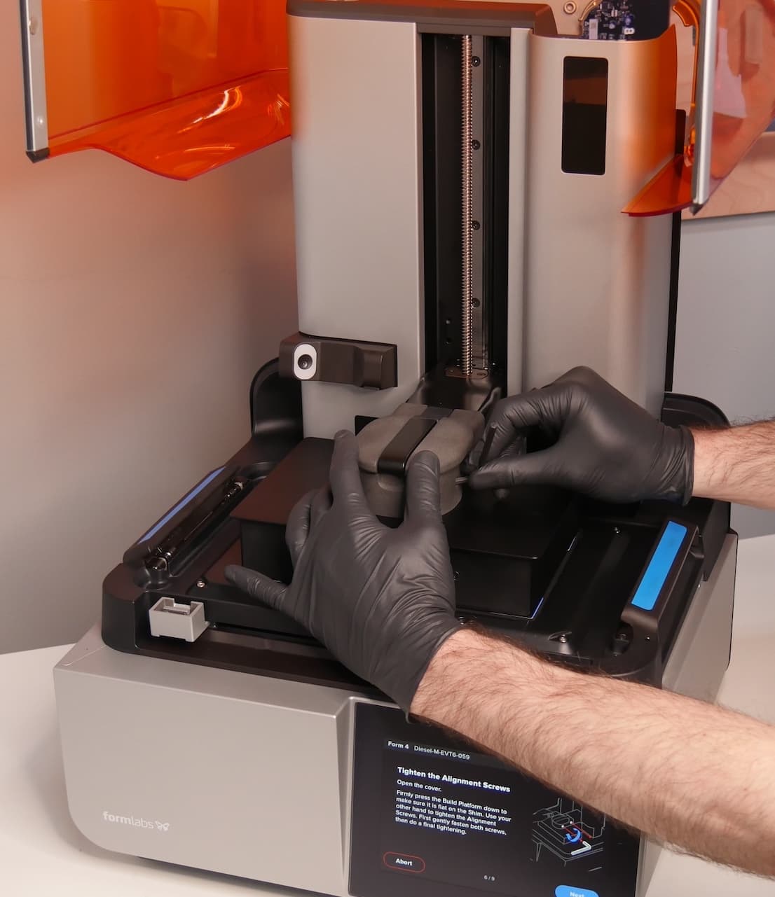

  1. Close the cover. The printer lowers the build platform to lie flat on the LPU texture.
  2. Open the cover.
  3. With one hand pressing the build platform to lie completely flat on the LPU texture, use a hex key to tighten the alignment screws over two passes.
    • Use the 4 mm hex key to tighten the alignment screws on Form 4 generation printers. Ensure that both screws are secure.
    • Use the 5 mm hex key to tighten the alignment screws on Form 4L generation printers. Ensure that all screws are secure.
