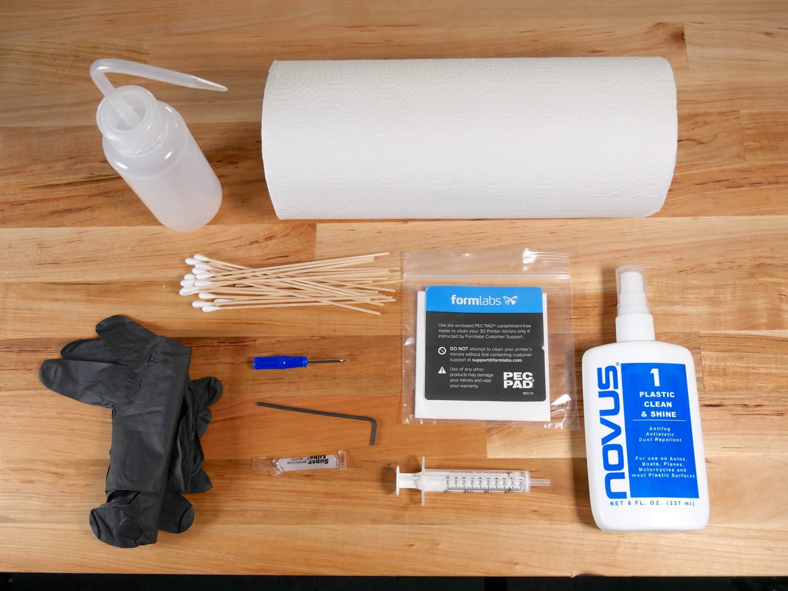

Recommended supplies:
  • Nitrile gloves
  • Soap and water
  • Low-fiber paper towels or disposable microfiber cloths
  • Clean IPA (70% or higher)
  • Cotton swabs
  • PEC*PADs
  • Novus 1: Plastic Clean & Shine, or similar plastic cleaner
  • Plastic spatula or similar
  • Flashlight
  • Disposable syringes or medicine droppers

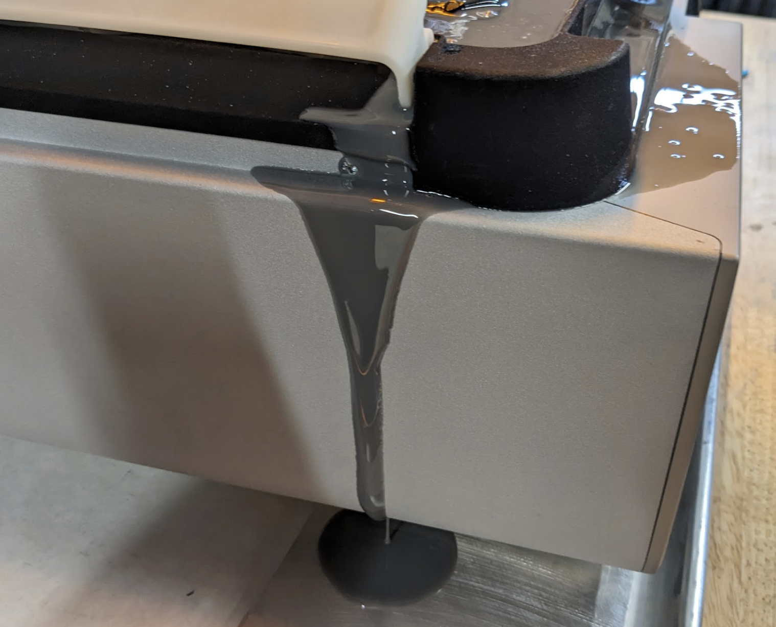

Inspecting and cleaning external surfaces
Liquid resin on the outside of the printer can make the printer difficult to use or contaminate other work surfaces. Clean the cover, shell, and ports if resin spills on them.
Orange cover
  1. Inspect both the inside and outside of the orange cover.
  2. Clean any liquid resin using paper towels dampened with soap and water.
Shell
  1. Dab the shell with paper towels to absorb liquid resin. Avoid smearing resin across the surface.
  2. If resin has cured on the surface of the shell, scrape off the cured resin using a plastic spatula. A metal spatula may scratch the shell.
  3. Clean the remaining resin off external surfaces with soap and water.

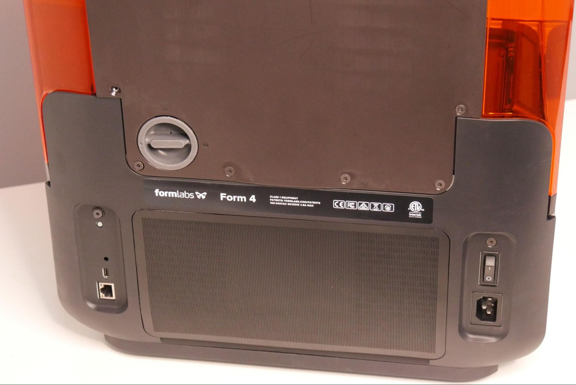

USB port, Ethernet port, power jack, and power switch
alttext
  1. Inspect the USB port, Ethernet port, power jack, and power switch on the back of the printer for resin contamination.
  2. If needed, clean the contacts inside the port or power jack using cotton swabs and a small amount of IPA.

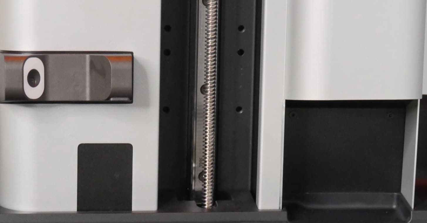

Inspecting the Z-axis
The Z-axis assembly contains the motor and lead screw that drive the build platform carriage. They must be clean for the build platform to move smoothly and accurately. There is a drip catcher below the cartridge slot, which can help prevent or mitigate any future resin spills.
Z-tower and drip catcher
  1. Clean any resin droplets on the Z-tower with a paper towel or cotton swab dampened with soapy water.
alttext
  1. Shine a flashlight on the drip catcher in the base of the tower and visually inspect it for spilled resin.
  2. Remove pooled resin using a syringe and dispose using the proper procedures for liquid resin.
  3. Soak up any remaining resin with a paper towel.
  4. Clean any final traces of resin with soapy water and a clean paper towel.
Z-motor and lead screw
alttext
  1. Shine a flashlight down the lead screw and inspect the Z-motor inside the bottom of the tower to determine whether resin has seeped down the lead screw and into the bearings. If resin has seeped into the bearings or motor, take photos and contact Formlabs Support or your authorized reseller for additional assistance.
  2. If there is resin on the lead screw, but the Z-motor itself is clean, remove the resin on the lead screw with a paper towel or cotton swab and a small amount of IPA.
Tip:
If the lead screw is cleaned with IPA, lubricate the lead screw with Rheolube 362HB before printing again to prevent build platform movement issues.
