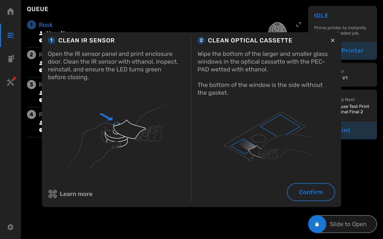

  2. Inspect the IR sensor and optical cassette. Clean if necessary.
Reminders to clean the IR sensor and optical cassette before priming a Fuse 1 generation printer

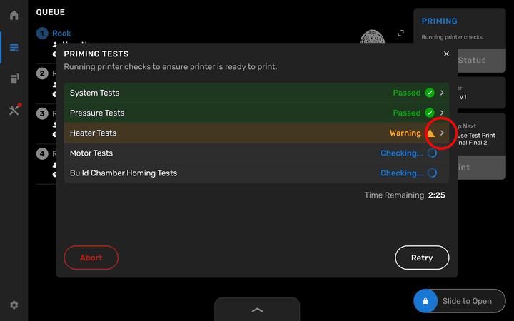

  1. If any of the tests fail, tap the arrow next to the failed test and follow the on-screen instructions to ready the printer for printing. When the printer is ready for printing, the printer’s touchscreen and PreForm status both display as Primed.
A Fuse 1+ 30W printer running preprint tests while priming
