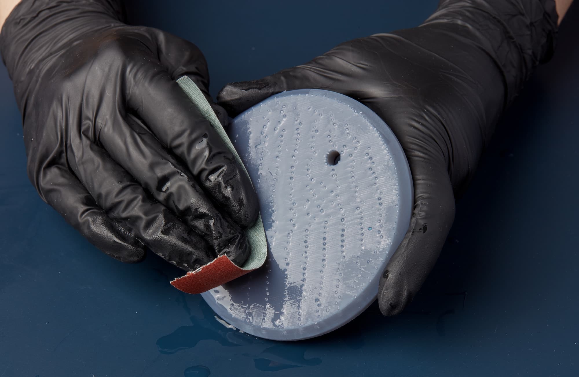

Dry sanding
Removing support touchpoints sometimes leaves raised marks and divots on a part’s surface. To reduce these marks, sand the surface with sandpaper.
Caution:
Follow general safety precautions when sanding plastics. Wear a face mask to prevent breathing in dust. Wear gloves to keep dust off hands, or wash hands thoroughly after sanding a part. Consider wet sanding to reduce dust accumulation and exposure.
Begin with the lowest or roughest grit sandpaper and sand surfaces as desired. Consider using a sequence of 150, 220, 400, 800, 1000, and 2000 grit sandpapers, depending on the available supplies and desired surface finish.
Use a squirt bottle to rinse parts with IPA or water, or brush parts with a toothbrush to remove dust.
Wet sanding
Wet sanding reduces dust and creates a finer surface finish. Use mineral oil or even water to wet sand printed parts. Wear gloves to keep dust and sanding liquid off hands.
