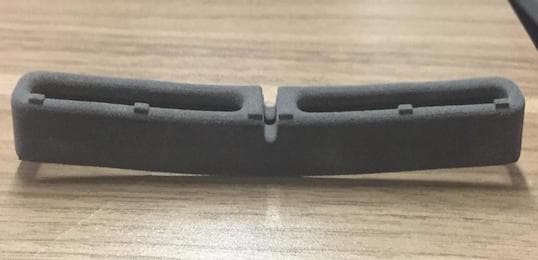

Symptoms
  • Unexpected curvature on parts
  • Deviation from expected model shape such as bends, twists, or a potato chip shape

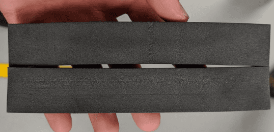

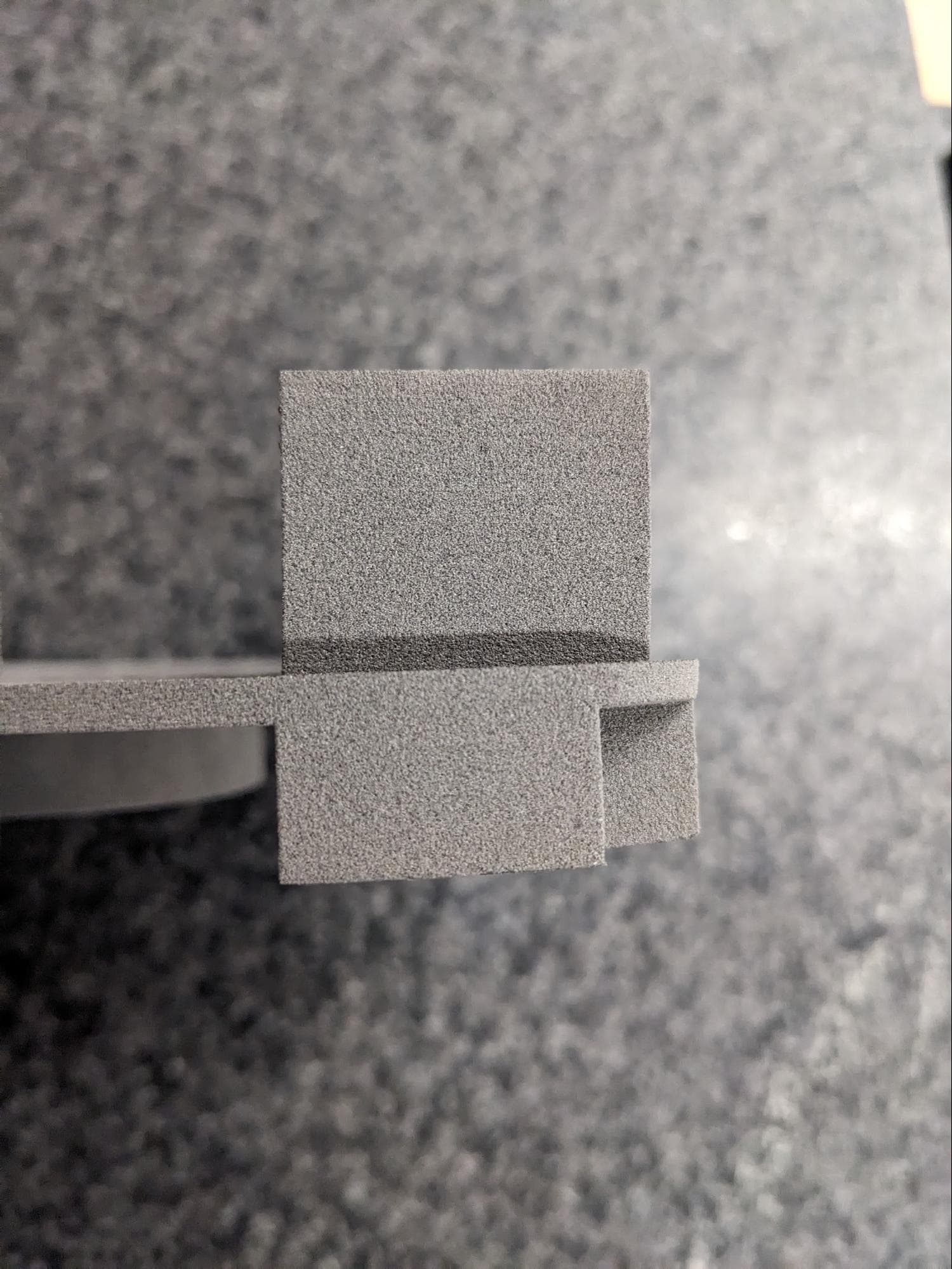

Check which regions of the part have warped
If only the lower sections of a part are curved while the rest of the part is unaffected, follow the troubleshooting steps for curling in the support article Fuse 1 generation error messages: PrinterWatcher aborts (Error 112, 113, 114, 216, 217).
Warping example
Warped part

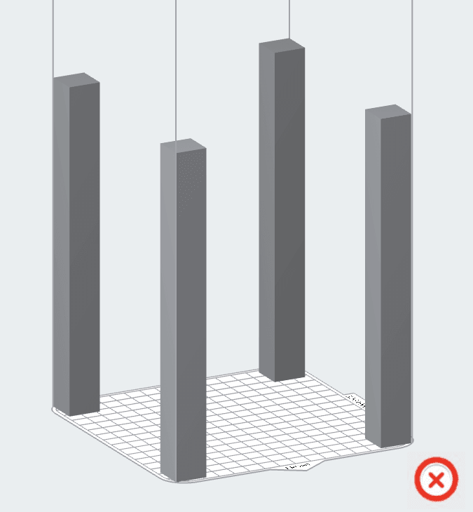

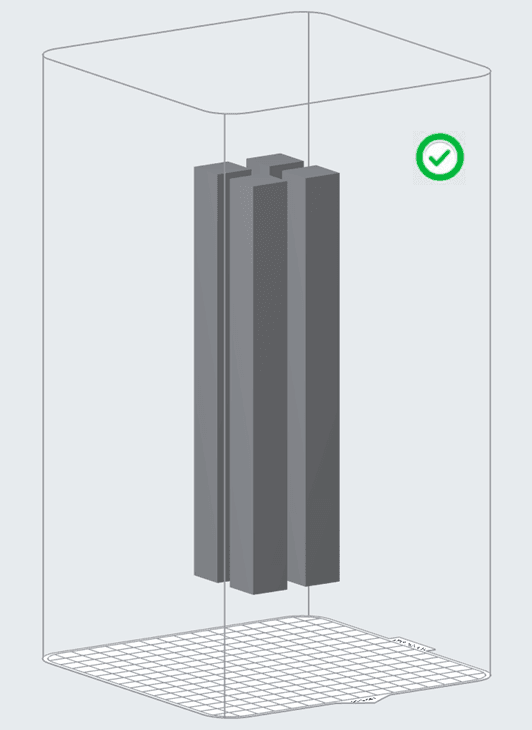

Improve part orientation
Orient long and slender parts as close to the center of the build volume as possible. Long and slender parts near the edges of the build volume are most prone to warping.
