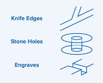

Design of traditional wax patterns and 3D printed resin patterns share many principles, such as the importance of smooth surface flow. Where possible, avoid creating sharp corners and edges. Sharp edges not only increase metal turbulence, but they also concentrate expansion stresses in the mold.
Line drawings of knife edges, stone holes, and engraves
Concentrated expansion stress causes investment breakage, which is one of the most common quality issues in direct-resin casting. Signs of investment breakage are filled-in negative features such as engraves and stone holes in the cast part. Investment breakage is usually accompanied by rough cast surfaces or pitting, resulting from investment debris.
In addition to sharp edges, be mindful of the depth of negative features. A good rule of thumb is to keep engraved channels and holes wider than they are deep. This guideline is more important if the negative feature is small, and the investment that fills around the feature is fragile.
In the Formlabs ecosystem, True Cast Resin and Castable Wax 40 Resin are designed to minimize expansion and investment breakage, allowing for more reliability where negative features are required. Compare jewelry casting resins here.

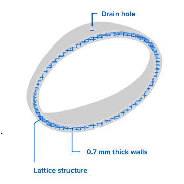

True Cast Resin is suitable for printing and casting thick jewelry parts up to 5 mm thick, such as heavy class rings, while Castable Wax 40 Resin can accommodate cross sections up to 4 mm in most places in the model. Thick regions of a model will tend to perform better in casting the closer they are to the feed sprue. Note that for investment casting large parts with geometries thicher than 3 mm, Clear Cast Resin is also an option.
Diagram showing wall thickness, lattice structure, and drain hole
Castable Wax Resin is an alternative material for designs that are both large and monolithic, such as statues. Due to Castable Wax Resin’s higher green strength, this material supports hollowing designs to a thin-walled shell. This strategy minimizes expansion forces on the investment during burnout. Parts thicker than 3 mm should be shelled, and drain holes must be added to allow resin to flush out of the hollow interior.
Formlabs recommends 0.7 mm thick walls for hollow shells printed in Castable Wax Resin. A lattice structure can also be added to the interior to improve the handling strength of large shelled parts. When creating a hollow thin-shelled pattern in Castable Wax Resin, check for areas of the model that are close to (or less than) double the minimum 0.7 mm wall thickness for the shell. These areas may be untouched by a shell CAD operation, resulting in regions of the pattern that are too thick for casting. Excessively thick parts are likely to cause expansion cracks during burnout.

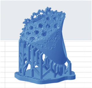

The exceptional detail of Castable Wax Resin allows you to create pieces with intricate filigree. These fine meshes of wires are challenging but possible to cast with careful sprue design.
Fine meshes can be printed with a wire diameter as thin as 0.3 mm. Printed filigree is fragile and easily damaged by support removal. Design filigree parts to be as self- supporting as possible.
In filigree designs, 3D printed sprues may serve a dual purpose as “supports” that are removed after casting. To avoid metal freezing in these thin channels, add sprues that feed metal to many points on the rim of a filigree mesh.

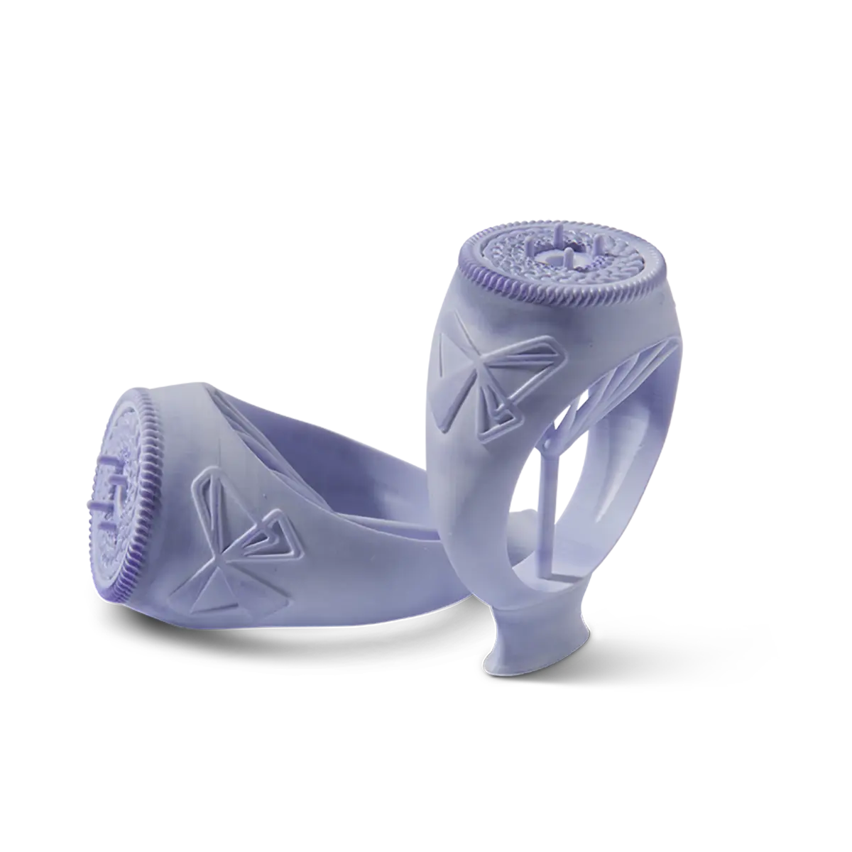

Jewelry patterns can be printed individually or in batches on Formlabs stereolithography (SLA) desktop 3D printers.
Orientation
  • For the best quality prints in Castable Wax 40 Resin, we recommend printing top-heavy parts such as signet rings oriented and supported at an angle, rather than vertically.
  • Lighter weight jewelry designs, and parts printed in Castable Wax Resin, may be printed vertically.
  • For rings and other small parts printed in True Cast Resin, orient vertically to minimize support touchpoints. For all other models, orient 30-45 degrees relative to the build platform.
Ring oriented in PreForm
Orient top-heavy parts at an angle for best results.

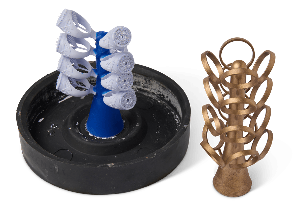

3. Build the Sprue Tree

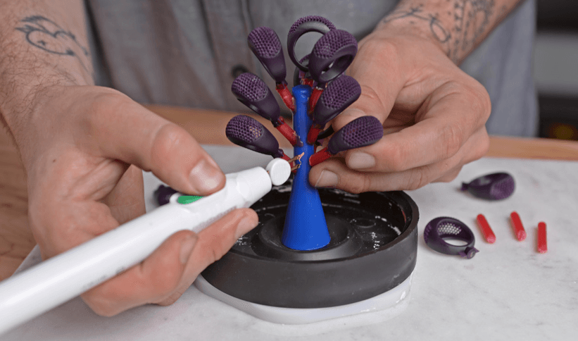

Attach the post-processed prints to a main wax sprue with sticky sprue wax. Melt the wax to create smooth junctions between each printed pattern and its feed sprue.
Person using a heat pen to join resin patterns to the wax sprue tree
A wax heat pen makes it easier to join resin patterns to the wax sprue tree.
Arrange thicker parts at the bottom and thinner parts at the top of the tree. 3D printed parts may require slightly more space between parts than a traditional wax tree. If you are casting large “thin-shelled” parts, make sure to fill any drain holes with wax to prevent any investment material from entering the print.

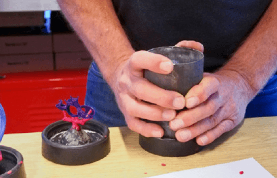

3. Slowly pour the investment down the side of the flask, avoiding the pattern tree. A smooth pour is less likely to trap bubbles. Use a vacuum chamber to extract any bubbles from the flask. Allow the investment to harden and dry.
4. Carefully remove rubber sprue base from the flask and allow it to set in a vibration-free environment for 2-6 hours. Follow the investment manufacturer’s safety recommendations. We recommend wearing a dust mask or respirator.

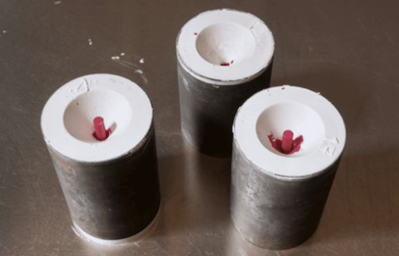

5. Burnout and Casting

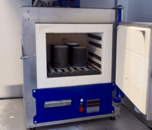

Place the casting flask in the burnout oven and heat using the recommended Burnout Schedule. Make adjustments depending on the investment instructions, flask size, and amount of printed material.
Formlabs recommends using a well-ventilated furnace (with an inlet and an outlet), to provide sufficient air flow throughout the chamber and to safely exhaust all vaporized resin material.
SHORT BURNOUT
Significantly shorter burnouts (four to eight hours) are limited to lightweight geometries and strong phosphate-bonded investment materials. Phosphate bonded investment will allow for a faster burnout with all Formlabs casting resins.
Tips:
  • Venting is essential, but it can cause the temperature in the oven to drop. Monitor the oven and flask temperature and adjust your process as you develop a burnout schedule suited to your own equipment.
  • If using active ventilation, increase suction as much as possible to improve airflow throughout the oven.
  • If the oven is full, burnout will be less effective per flask. Attach an oxygen generator or low flow air line to the oven to increase the airflow.

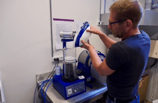

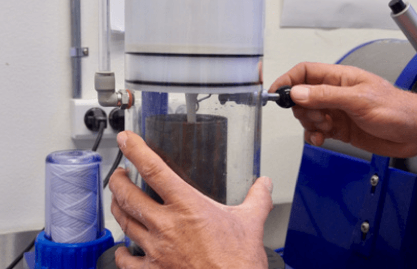

Remove the mold from the furnace and cast metal. Centrifugal or vacuum casting machines such as the Neutec J2R (USA) and the Indutherm MC-series (EU) are simple to use and highly controllable. After casting, carefully quench the mold in water and wash away the investment.

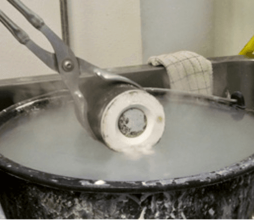

Quenching the flask
Place flasks in a well-ventilated burnout oven.
Vacuum or centrifugal casting improves fill to thin details.
Quench and de-vest the flask by submerging it in water.

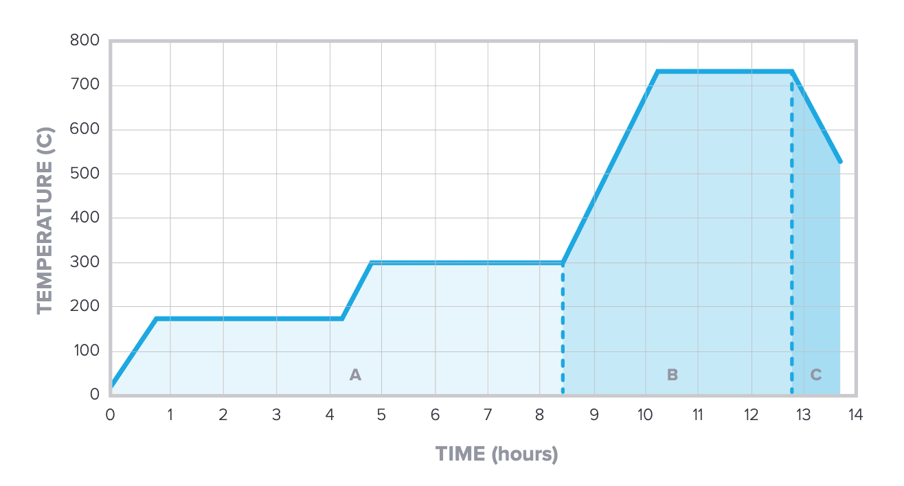

True Cast Resin
View a full breakdown of times and temperatures based on investment and metal in our guide to using True Cast Resin here.

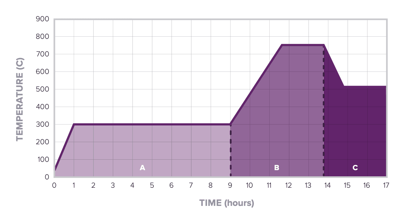

Graph showing the burnout schedule of Castable Wax 40 Resin
Phase
Time
Schedule °C
Schedule °F
Heated Flask Drying
180 min
55 °C
131 °F
A
Ramp
48 min
2 °C/min
3.6 °F/min
Hold
180 min
150 °C
302 °F
Ramp
75 min
2.0 °C/min
3.6 °F/min
Hold
108 min
300 °C
572 °F
B
Ramp
108 min
4.0 °C/min
7.2 °F/min
Hold
180 min
732 °C
1,350 °F
C
Ramp
44 min
-5 °C/min
-9 °F/min
Casting Window
Up to 2 h
Desired casting temp
Graph of Castable Wax burnout schedule
Phase
Time
Schedule °C
Schedule °F
A
Insert Flasks
0 min
21 °C
70 °F
Ramp
60 min
4.7 °C/min
8.4 °F/min
Hold
480 min
300 °C
572 °F
B
Ramp
100 min
4.5 °C/min
8.1 °F/min
Hold
180 min
750 °C
1,382 °F
C
Ramp
60 min
-4.0 °C/min
-7.1 °F/min
Casting Window
Up to 2 h
