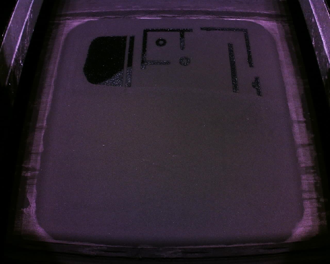

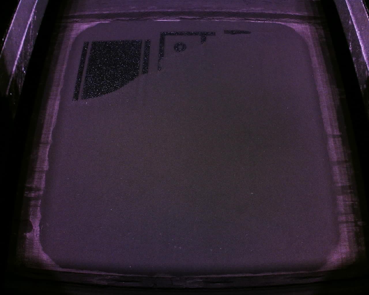

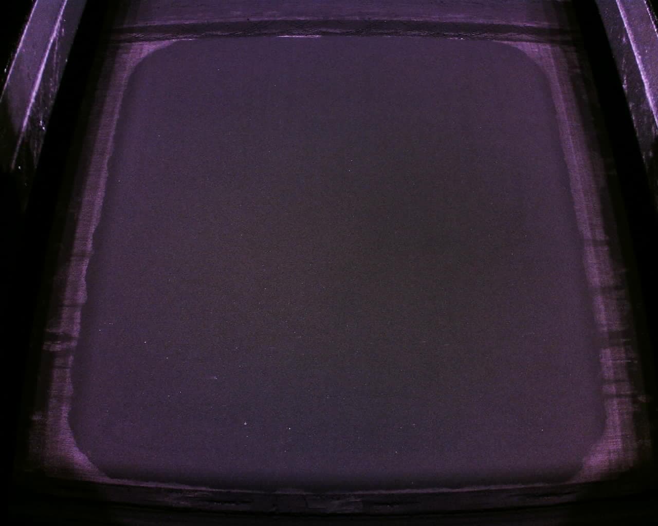

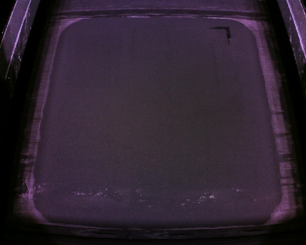

Viewing print photos
The folder PrinterWatcherFrames contains subfolders for prints that failed due to PrinterWatcher errors, each with 10 print photos taken by the onboard camera. These are the same photos shown on the printer touchscreen after these errors, and can be particularly helpful when diagnosing a print failure or troubleshooting an error message related to the PrinterWatcher system. Several sample images are given below.
Example PrinterWatcher image
