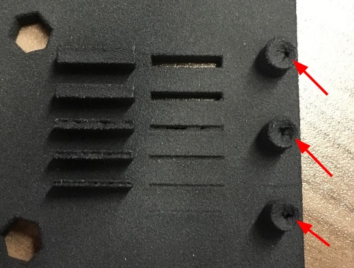

Dimpling and pitting
Symptoms:
  • Top surfaces of parts are sunken in (dimpling) or completely collapsed (pitting)
Troubleshooting steps:
Dimpling and pitting (SLS)
SLS parts with pitting

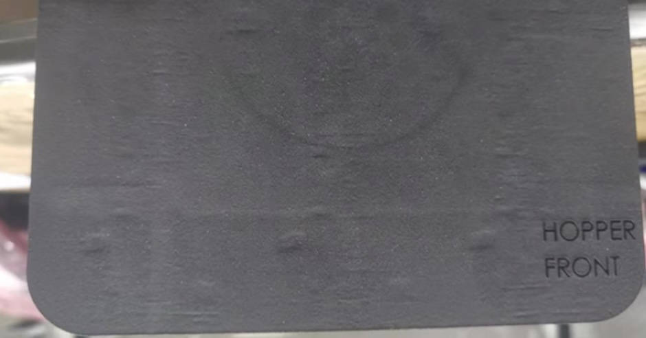

Poor finish or orange peel texture on vertical surfaces
Symptoms:
  • Ridges or waves across vertical surfaces
  • Surfaces closer to the edges of the build volume may have this while other surfaces do not
Poor finish on vertical surfaces (SLS)
SLS parts with poor surface finish

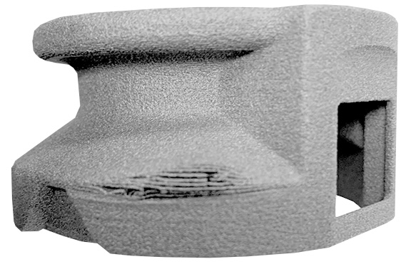

Fragile parts
Symptoms:
  • Printed parts crumble easily and their texture is more grainy than usual
Fragile parts (SLS)
SLS fragile parts
