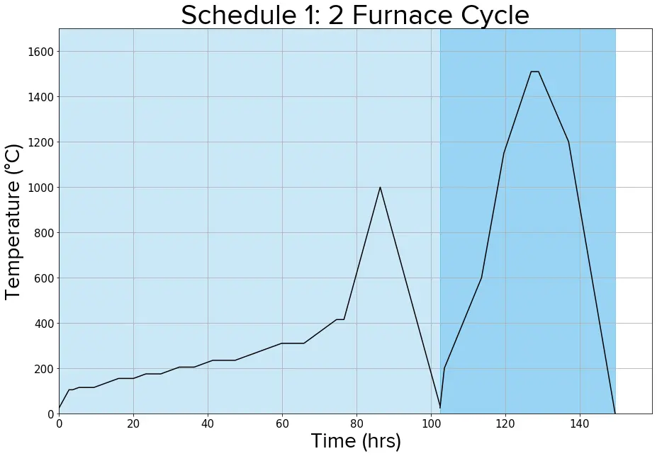

Two-furnace schedule
Formlabs recommends using a 4.5-day burnout and 2-day sintering firing schedule to achieve the mechanical properties shown in the technical data sheet (TDS).
Two furnace schedule.
TIME STEP (min) TOTAL TIME (hr) END TEMP °C RATE °C/min
0 0 25
160 2.67 105 0.5
60 3.67 105 0
100 5.33 115 0.1
240 9.33 115 0
400 16 155 0.1
240 20 155 0
200 23.33 175 0.1
240 27.33 175 0
300 32.33 205 0.1
240 36.33 205 0
300 41.33 235 0.1
360 47.33 235 0
750 59.83 310 0.1
360 65.83 310 0
525 74.58 415 0.2
120 76.58 415 0
585 86.33 1000 1
965 102.42 35 1
0 102.42 25
70 103.58 200 2.5
600 113.58 600 0.67
360 119.58 1150 1.53
440 126.92 1510 0.82
120 128.92 1510 0
485 137.00 1200 -0.64
750 149.50 0 -1.6

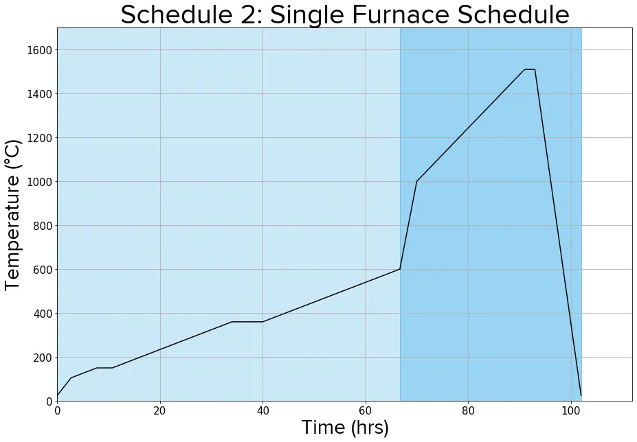

Single-furnace schedule
For firing only in a sintering kiln, Formlabs suggests a schedule of 2.5-day burnout and 2-day sintering. Using a single furnace eliminates the risk of breaking brown parts while transferring from a burnout oven to a sintering kiln. Repeated use of a single furnace schedule may limit the service life of some elements on some kilns, as well as having a slightly less accurate burnout.
Single-furnace schedule.
0 0 25
160 2.7 105 0.5
300 7.7 150 0.15
180 10.7 150 0
1400 34.0 360 0.15
360 40.0 360 0
1600 66.7 600 0.15
200 70.0 1000 2
1260 91.0 1510 0.40
120 93.0 1510 0
540 102.0 25 2.75

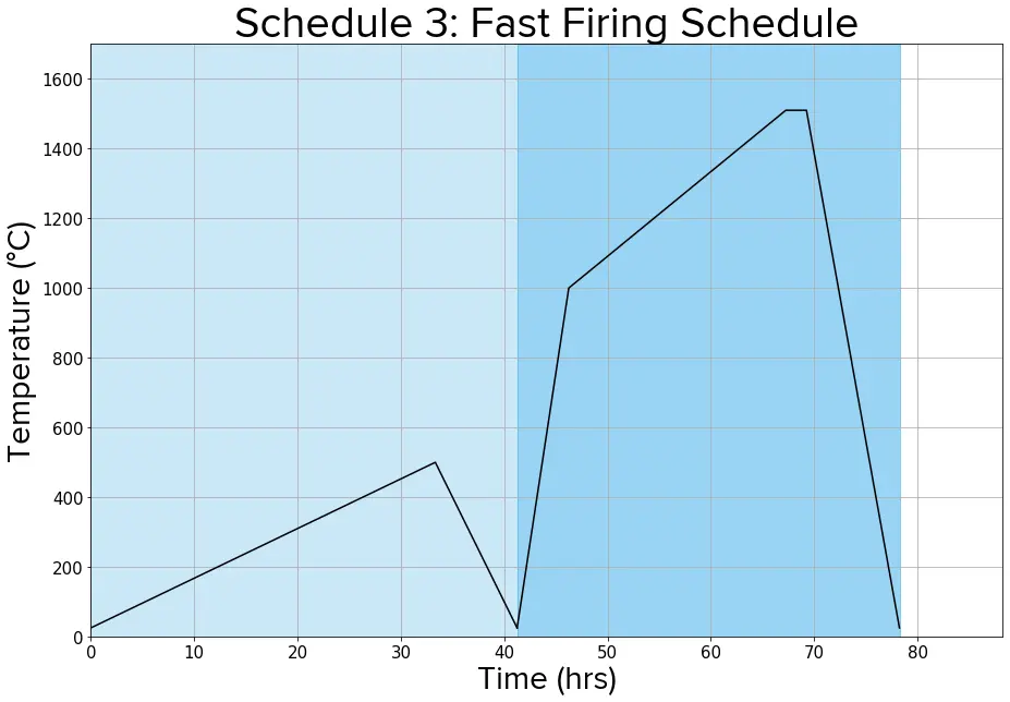

Fast firing schedule
For extremely thin parts, Formlabs suggests a fast firing schedule of 2-day burnout and 2-day sintering. Only use this schedule for extremely thin parts that do not need a long burnout time to evacuate organics.
0 0 25
2000 33.33 500 0.25
475 41.25 25 1
0 41.25 25
300 46.25 1000 3.25
1260 67.25 1510 0.40
120 69.25 1510 0
540 78.25 25 2.75
