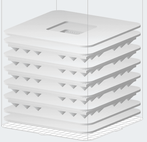

Default (v2.0) Bed Temperature Tuning print in PreForm
alttext
Legacy (v1.1) Bed Temperature Tuning print in PreForm

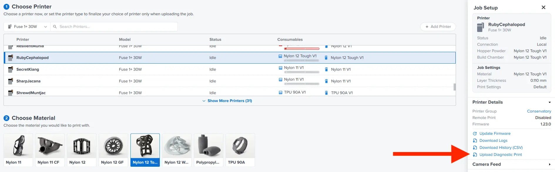

  3. Open PreForm and select Job Settings.
  4. In the Job Setup window, make sure the correct printer is selected, then select Upload Diagnostic Print.
alttext
  1. Select the file from your computer. Once the file has successfully uploaded, start the print from your printer.

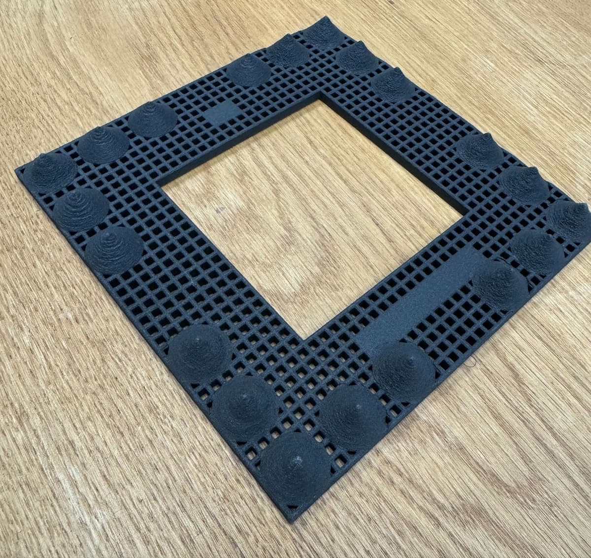

Parts should be fully cleaned of powder prior to inspection either by the Fuse Blast or other media blasting solutions. Extract the five plaques.

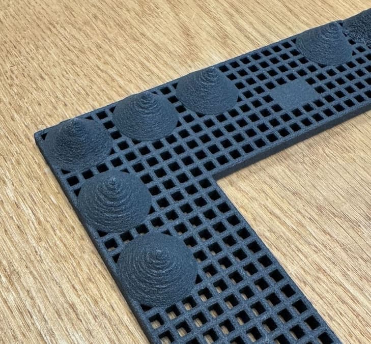

On the Default (v2.0) print setting test print, each plaque has nine clearance pieces. On the Legacy (v1.1) print setting test print, each plaque has cones on a grid. The additional flat plaques in the build are used to create equal cooling and separation between each cone plaque and can be discarded.
Example of a cleaned plaque from the Default (v2.0) print settings test print ready for inspection
Example of a cleaned plaque from the Default (v2.0) print settings test print ready for inspection.
A cleaned Nylon 12 Tough Powder tuning print
Example of a cleaned plaque from the Legacy (v1.1) print settings test print ready for inspection.
Each plaque is listed with the temperature offset it was printed with (-2 ºC, -1 ºC, 0 ºC, +1 ºC, +2 ºC). Line the plaques up from -2 ºC to +2 ºC to prepare for inspection.

To determine the appropriate temperature offset for your printer, look for the plaque at the coldest temperature setting that has the fewest instances or no instances of orange peel.
Rotate the plaques to inspect the cones from all angles. Orange peel appears as a slightly layered surface on the cones.
An example of orange peel on a part printed with Nylon 12 Tough Powder
