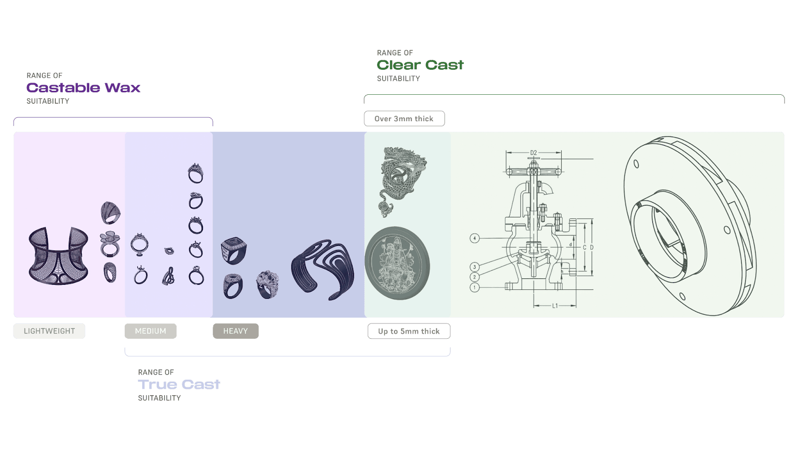

When choosing a casting resin, take the casting properties of each material into consideration. For smaller parts or wire filigree, use Castable Wax Resin. For medium to heavy jewelry or small engineering components, use True Cast Resin. For larger investment casting, use Clear Cast Resin.
Suitability range for Formlabs castable resins

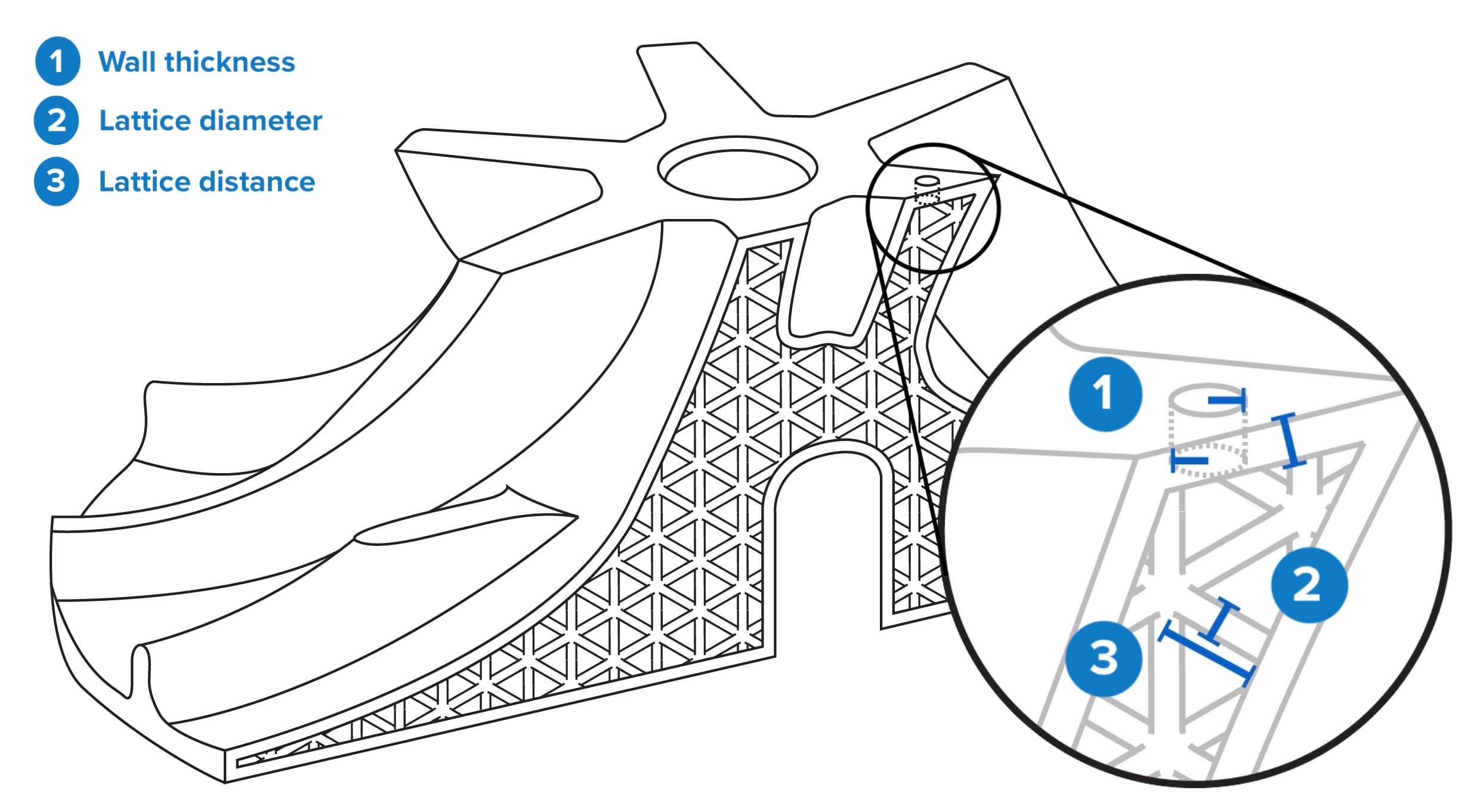

Sacrificial patterns for industrial investment casting must be strong enough to withstand the pressure of being dipped in ceramic slurry while also being thin enough to burn away. Thin walls prevent cracking caused by thermal expansion during burnout. Software solutions are available that hollow the part and build inner lattice scaffolding to strengthen the part. The lattice supports the exterior of the part, prevents warping, and enables printing with thin walls. The sprue can also be 3D printed as part of the pattern. Since the lattice is required to create quality castings, it is recommended not to go below ⅛ inch or 3 mm for the majority of the part.
After designing the part with your CAD software, import the CAD file into the lattice module and determine the settings for the outer shell, the lattice structure, and drain holes. Thinner walls improve casting success, but they increase the risk of print failures and may weaken parts.
Print feature recommendations
 Wall Thickness Lattice Diameter Lattice Distance
Highly Conservative 1 mm 1 mm 3 mm
Conservative 1 mm 0.50 mm 3 mm
Common0.75 mm 0.75 mm 3 mm
Recommended0.5 mm 1 mm 3 mm
Detail Size0.5 mm (standard)
Hole Size2 mm (minimum, increase as needed)
