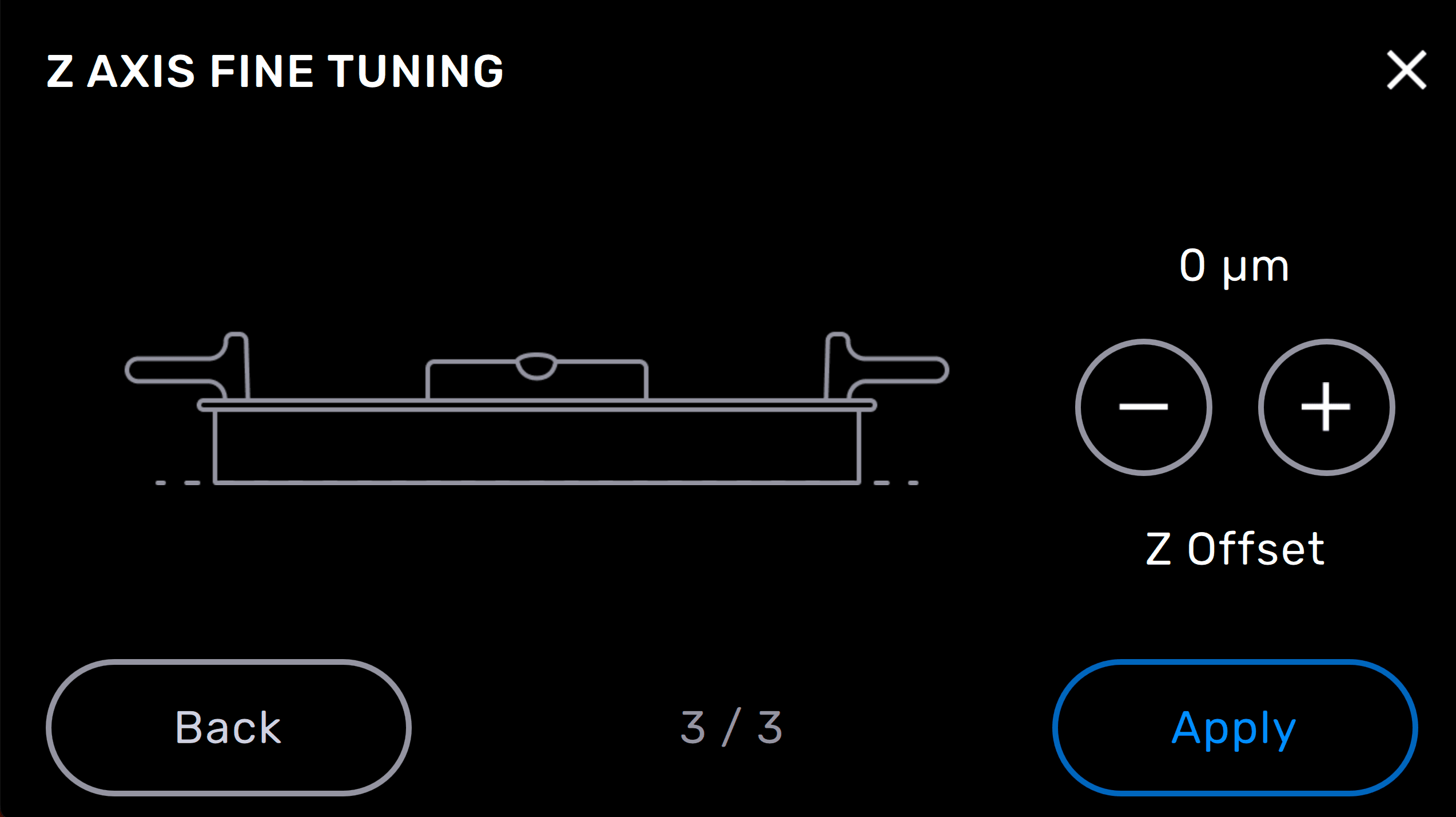

Step 2: Fine tune the Z-axis
Z Axis Fine Tuning changes the height of the build platform above the tank’s elastic layer before the first layer adheres to the build platform. Small adjustments adding to the build platform’s height may correct Z-compression in models.
Tip:
Your PreForm settings do not change when adjusting the Z-axis.
To fine tune the Z-axis on a Formlabs LFS printer:
  1. Update the printer’s firmware.
  2. Ensure that the printer is not running a print job and is currently Idle.
  3. Access the Z Axis Fine Tuning screen.
    1. Form 3 product line: Tap the gear icon on the printer’s touchscreen. The Settings screen appears. Tap Maintenance > Calibration > Fine Tune Z-Axis. The Z Axis Fine Tuning screen appears.
    2. Form 3L product line: Tap the wrench icon on the printer’s touchscreen. The Maintenance screen appears. Tap Calibration > Fine Tune Z-Axis. The Z Axis Fine Tuning screen appears.
  4. Tap the + button above Z Offset to raise the default position of the build platform and increase the value in increments of 50 µm. The highest available Z Offset value is 1000 µm.
  5. Start by changing the Z Offset value to 50 µm. Tap Apply to save the value and return to the Settings screen.
  6. Print small models to test the change and continue to adjust the value until models print with consistent supports and rafts.
Tip:
Adjust the build platform height in increments of 50 µm, then print small models to test the change and continue to adjust the value until models print with consistent supports and rafts.

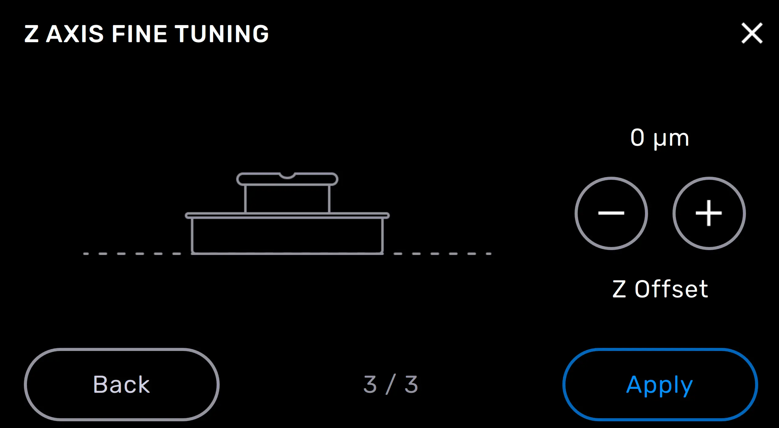

Z Axis Fine Tuning changes the height of the build platform above the tank’s elastic layer before the first layer adheres to the build platform. Small adjustments lowering the build platform’s height may correct non-adherence in models.
Tip:
When adjusting the Z-axis your PreForm settings do not change.
  4. Tap the - button above Z Offset to lower the default position of the build platform and decrease the value in increments of 50 µm. The lowest available Z Offset value is -1000 µm.
  5. Start by changing the Z Offset value to -50 µm. Tap Apply to save the value and return to the Settings screen.
  6. Print small models to test the change. Continue to adjust the value until models print with consistent supports and rafts.
Tip:
Adjust the build platform height in increments of -50 µm, then print small models to test the change and continue to adjust the value until models print with consistent supports and rafts.
