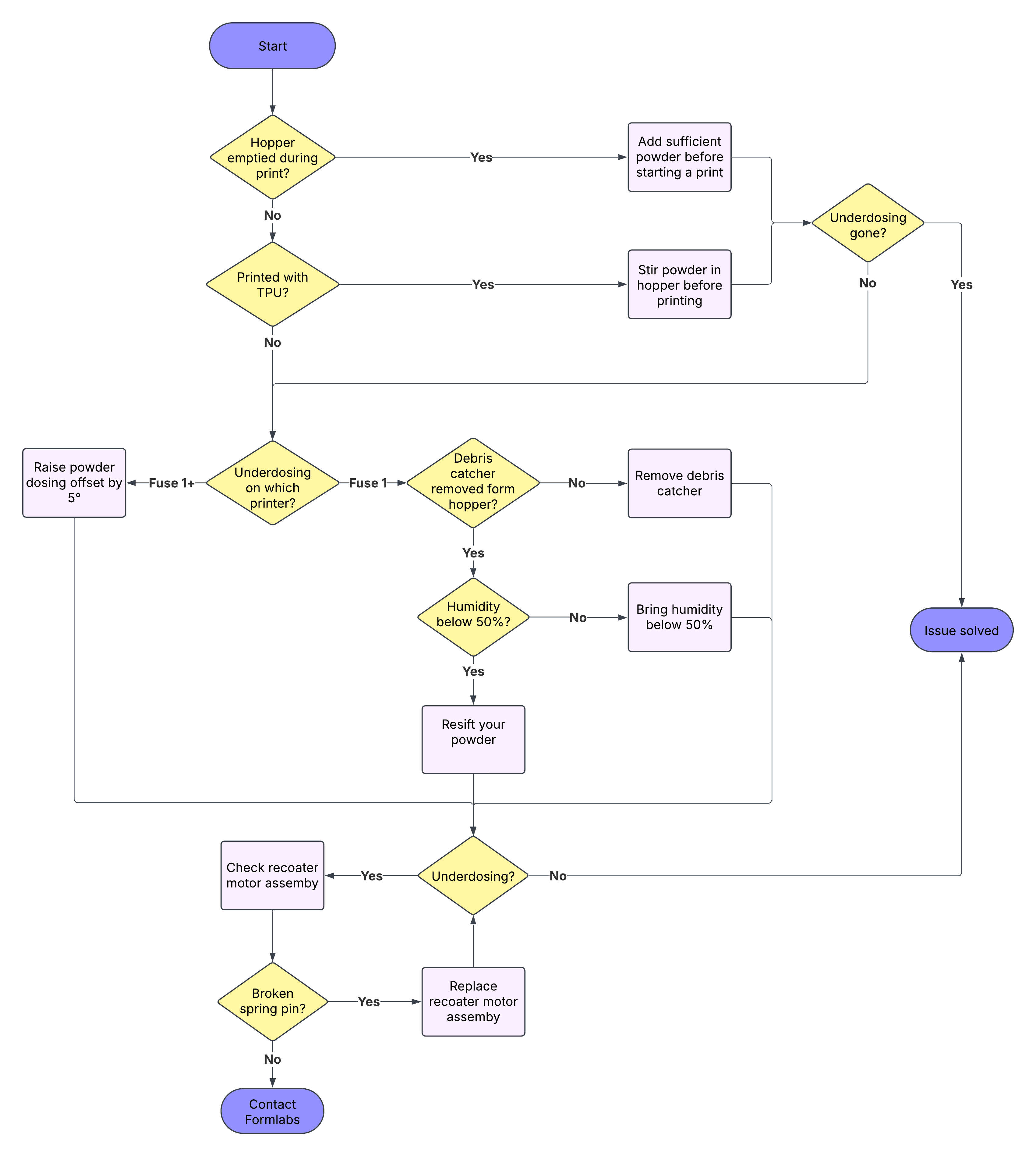

Troubleshooting steps
Underdosing troubleshooting steps for Fuse 1 and Fuse 1+ 30W printers
Human head (left-hand profile) wearing a mask
Warning:
Use appropriate personal protective equipment when handling loose or unsintered powder. Refer to the support article Safety with Formlabs SLS products for more information.
Add sufficient powder to the printer
If the hopper empties during a print, the print fails. Add sufficient powder and powder credit to the printer before starting a print.
Follow Formlabs recommended workflows
Certain materials clump more than others. This can cause obstructions that result in underdosing. Some materials, like TPU 90A Powder, require stirring to ensure that it flows properly.
When working with these materials, follow Formlabs recommended workflows as outlined in the support articles below:
Monitor humidity levels (Fuse 1)
Monitor humidity levels wherever unsintered powder is stored or used, including around the printer and Fuse Sift. High humidity (e.g., in excess of 50% relative humidity when printing with Nylon 12) can cause powders to clump and obstruct powder flow into the dosing system. Fuse 1+ 30W printers are also affected by humidity, but they have an agitator in the hopper to aid with dosing.
Keep humidity low in the work area. If necessary, install dehumidifiers or other air handling and conditioning units as needed.
Note:
Any moisture present in the powder evaporates once it enters the printer during a print, so it does not affect print quality.
Adjust the Powder Dosing Offset (Fuse 1+ 30W)
Formlabs recommends raising the Powder Dosing Offset by 5° to prevent print failures when printing with the following materials:
  • Nylon 12 Powder (v3.0 or higher print settings)
  • TPU 90A Powder (v2.0 or higher print settings)
  • Polypropylene Powder (all Fuse 1+ 30W print settings)
Remove the debris catcher (Fuse 1)
The debris catcher at the base of the printer’s hopper traps any foreign objects that may be in the powder before it flows into the dosing system. Debris accumulates behind the catcher, which can become clogged.
Remove all powder from the hopper and remove the debris catcher if you are experiencing underdosing with a Fuse 1 printer.
Note:
Remove the debris catcher if you are printing with Nylon 11 or if the relative humidity in your workspace cannot be maintained below 50%.
Resift your powder
Underdosing issues caused by debris or other contaminants may be resolved by passing the powder through the Fuse Sift.
  1. Check the Fuse Sift sifter mesh to ensure that all eight turnbuckles are engaging the brim and that the brim itself isn’t bent or distorted.
  2. Check the sifter mesh for holes, tears, or fraying strands.
  3. Insert an empty build chamber into the printer and empty the printer hopper. Vacuum the remaining powder out of the hopper and troughs.
  4. Resift the powder in the Fuse Sift.
  5. Refill the hopper with the freshly sifted powder.
Check the recoater motor assembly
If the previous steps did not fix the underdosing issue, inspect the recoater motor coupler.
  1. Following the repair guide Replacing the Fuse 1 generation recoater motor assembly [EN] until you have removed the recoater motor and can access the recoater motor coupler. Examine the recoater motor assembly for a broken or sheared spring pin.
  2. If the spring pin is sheared and the coupler wobbles on the shaft as shown in the video here, replace the recoater motor assembly following the repair guide.
  1. If underdosing alternates with Error 94/3 (PR_ERROR_MOTOR_MOVE_MISSED_HARDSTOP__RECOATER) or started one or more prints before the error appeared, replace the recoater motor assembly following the repair guide linked above. Fuse 1 generation recoater motor assemblies are available for purchase on the Formlabs Store.
Contact Formlabs Support
If the issue persists despite the actions taken, contact Formlabs Support or a certified service provider and upload diagnostic logs.
